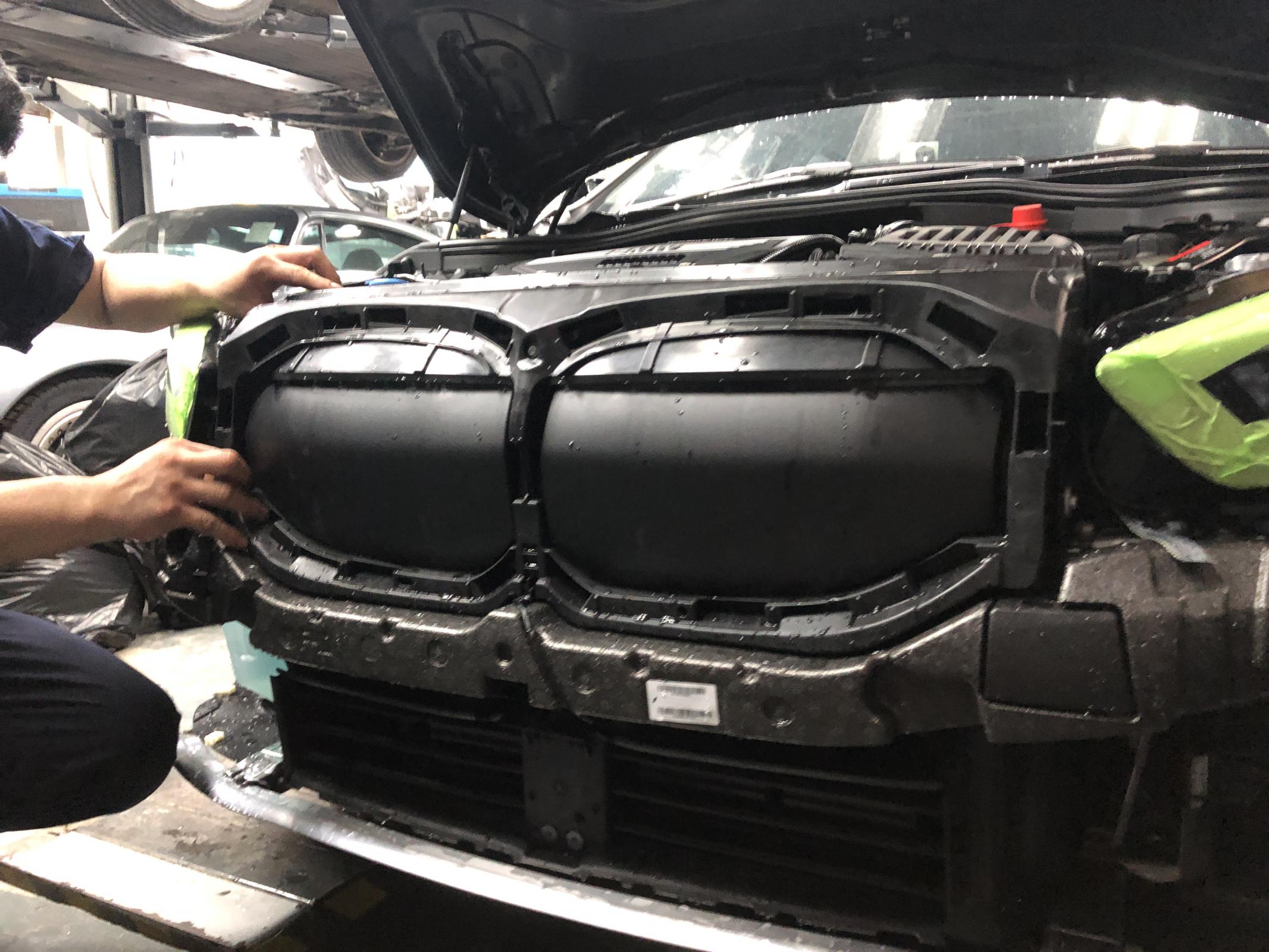

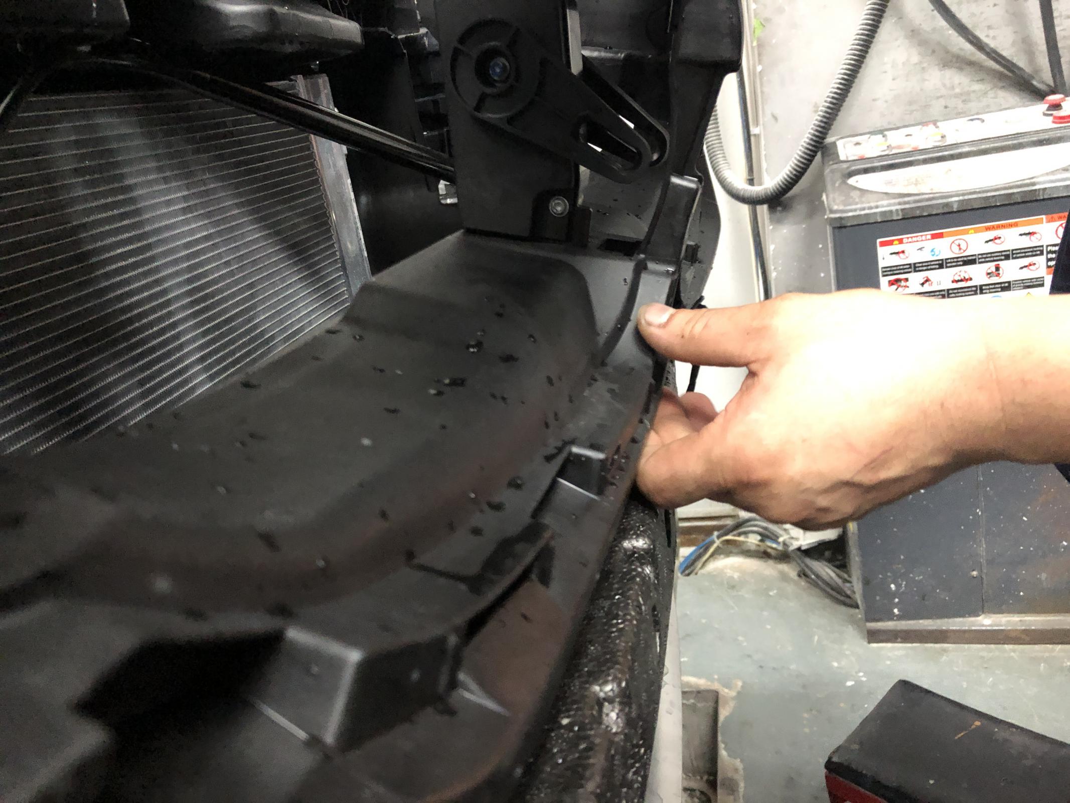

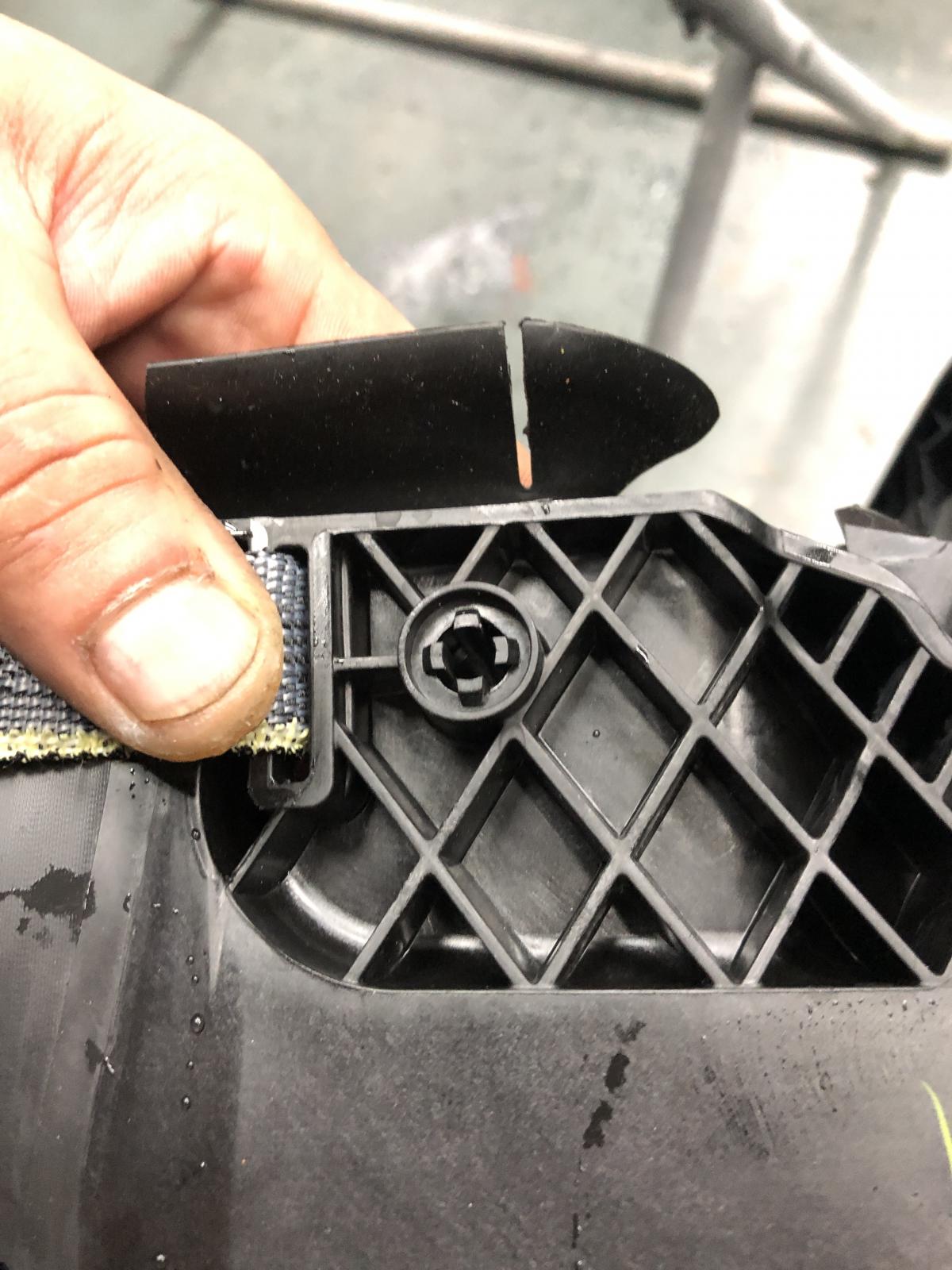

Got this new style of front grille from Bmw. However there's an extra step you need to do when you install a M135i front grille on a non M135i car, the intake flaps have to be removed. There won't be any fault codes or notifications showing that there is an error. Here is how it was removed.

Yo same here ! i am 118i also and installed M135i front grill and removed the air flap

Nice! Did you get it done on your own?

I did it and after 2 days I received a engine light for the air flap not staying within the specific rage of motion , I assume since the flap is gone it doesn't stop at the top and must go past a certain marker or angle .
Has anyone got this also and or fixed the issue
To protect my warranty I'm removing this grill and replacing it with the following which is acceptable full active grill cars.
51138080489

Quick question: Is it possible to NOT remove the intake flaps and install only the grille? My concern is that the cooler remains unprotected after removing it.

Hi, Can anyone walk me through this or recommend a UK fitter/styler who can replace my 118d m sport grill with the diamond mesh M135i grill i.e. remove adapt active grill in such a way to avoid CEL faults?
Thanks. I’ve seen the previous post from iCARMIX but I’m struggling to see exactly what’s happening from the picture. Also the thread suggests some followers still reaped fault codes… I’m grateful for any help on this…
