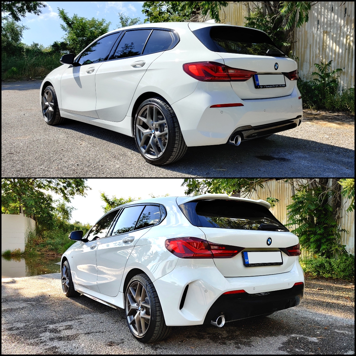

Hi to everyone.I'm very glad about my new project that have done.
After a long search on web i found a complete set of used bumpers with all of their accessories in excellent condition like new.The next step was to find a set of sidekirts and the rear top spoiler so it happened.But it will be needed extra brackets and some more little parts that is compatible only with the M packet bumpers.I ordered all of this from my local dealer.
All fits as plug n playbut the only modification that must be done is if you choose to put the M performance kindey grill you must remove the clapping behind of the grill.The reason is that this grill is vertical on the front side and the stock was curved.You clip out this panel and all will be ok with no errors.
The hole parts that purchase was
front bumper M
rear bumper M
side skirts M with black stripe
rear top spoiler M
kidney grill front M performance in shadowline black
front splitter from Maxton Design in gloss black
M side emblems
The extra parts that i need about the fitment was:
both side rear bumper's brackets M
front bumper absorder M
both sides at the front "triangle" wheelarch trims M
air duct M about the transmission cooler
and a few clips and nuts.
I will post photos from the car in whole the process before and after the convertion.
Enjoy them

Looks good Spyros
Would be interested to know how difficult the front bumper removal is as I might consider swapping my grill to the gloss black over serium grey.
Was this all your own work or done by a bodyshop for you?

Thanks a lot mate .The whole job done in to the paintshop.The difficult section which has the front bumper was the 2 screws per side that unite the fender with the bumper underneath of the wheel arch.
